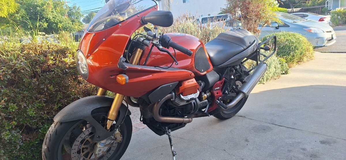

I found a sort-of easier way. Disconnected from the airbox and throttle bodies. Managed to get the upper and lower brackets off and out came the throttle body.

She was only running on the right cylinder. The left cylinder pipe was getting a little warm but not firing. Checked the spark and it was good. Only left fuel as the problem. Swapping fuel injectors to see if that fixes it.
This bike is a Rosso Corsa project bike I got about a year ago. Just now getting into it due to illness. It's been repainted except for the tailpiece and seat cowl. Only parts that still have Rosso scheme on them.
