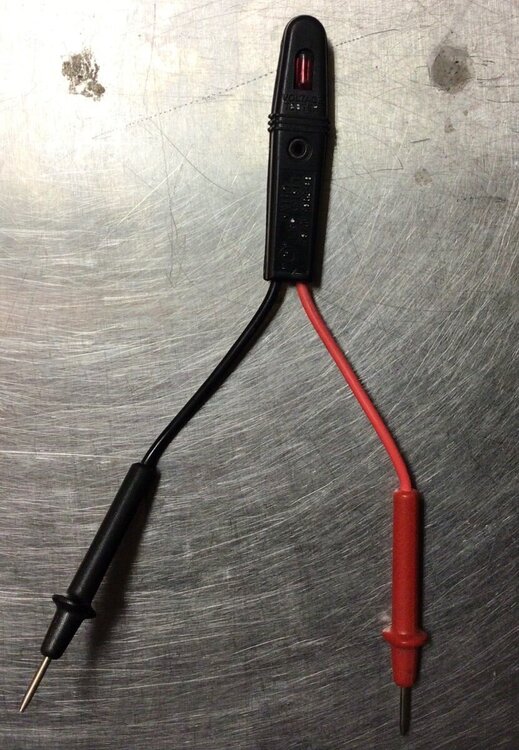

Perhaps 70 Ohms is a bad switch. Near zero would be preferable. A simple Test Light, like @gstallons often recommends, would be a way to test the switch: connect test light to positive--> touch probe to bare switch post. Light? Switch good. No light? Bad switch. If we can get the oil light out of the equation by determining it has nothing to do with the charge light, perhaps the search narrows.
