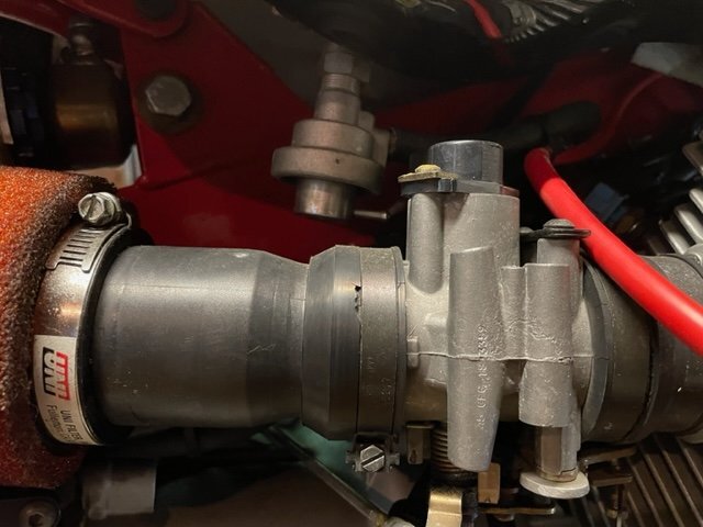

This is what I have on it currently. Looks like one piece vs 2 in diagram. Also, airbox end doesn't flair out to seal against the box, so I think its not correct.
My winter project is hopefully to complete a reinstall of the airbox on my V11. Having some trouble finding parts that go from throttle body to air box, specifically #19 in attached image. #4 are still for sale on mgcycle. Anyone have a source for decent used parts possibly? If not I may have to "modify" whats there somehow to make a tight connection to the airbox.

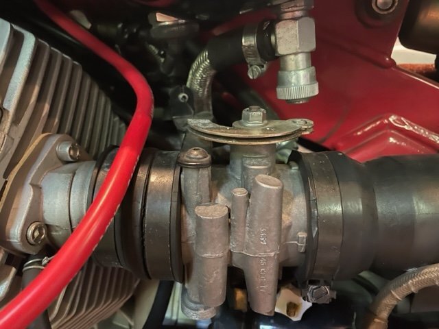

Yep. I was able to loosen the clamps and get it back on. Bike is running better than ever, I'm sure the valve job helped too. Good tip on the radio sockets, will look for those. I will have to learn how to check throttle body balance. Interesting you had exactly the same issue.
Ok, it is odd because I already purchased replacements for those hose bits connecting the throttle bodies to the valves. The screws for those clamps face directly up. Do you think I need/should pull the tank to fix it? How do I fix that without screwing up something else?
Went over to the bike to see if i could locate the right side idle set screw and noticed this. seems like the left side is not firmly connected to the engine and air is getting sucking in through there. like it got pushed back or something.
