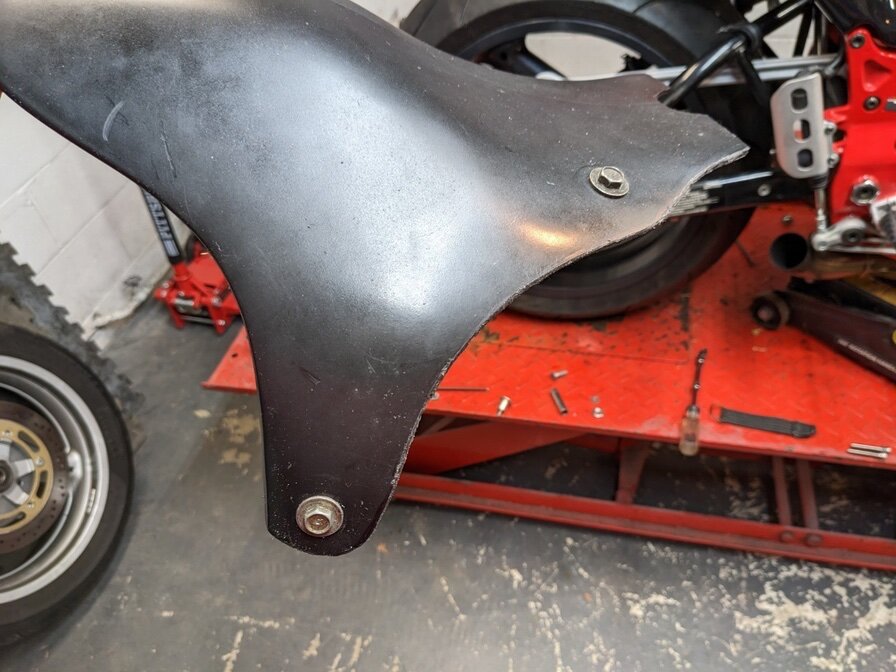

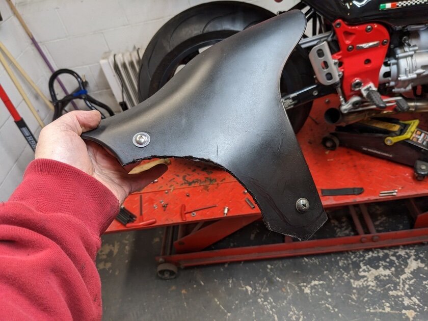

    2002 TL1000R

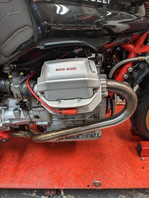

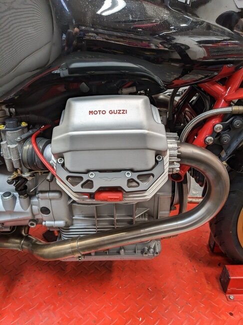

  7. In hopes that these protect my precious spark plugs…… From stock:
  8. I will put something together that covers the most critical aspect 1st: Where the 4 M6 holes get drilled. The contouring is defined by the hole locations. Paper overlays for the entire thing would be tough!

  11. Thanks everyone for the positive comments. If anyone decides to tackle this, my advice is to draw the cuts you want to make, take your time and leave generous excess to trim down. It’s not a lot of work, but it matters to get it looking how you want!
