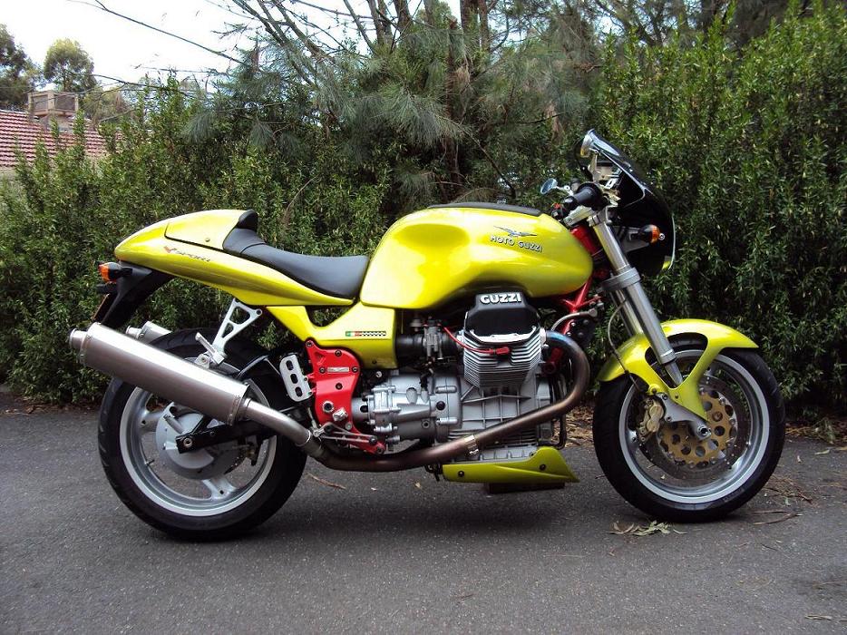

  6. They sound nice apart from a slight tendency to whistle at some points on the over run like an old Norton Commando.Just fitted a set of Mistral Titanium cans and they sound quieter and more mellow with no whistle at times.(see recent thread) Prefer the sound of the Ti cans and the look of the Megaphones. Ciao

  8. Got a great deal on these Mistral Ti pipes just recently.They sound nicer than the Mistral megaphone style I usually have fitted but I dont like the "look" as much.Bike seems to fuel slightly better with these as well. Ciao

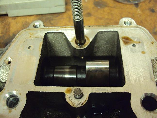

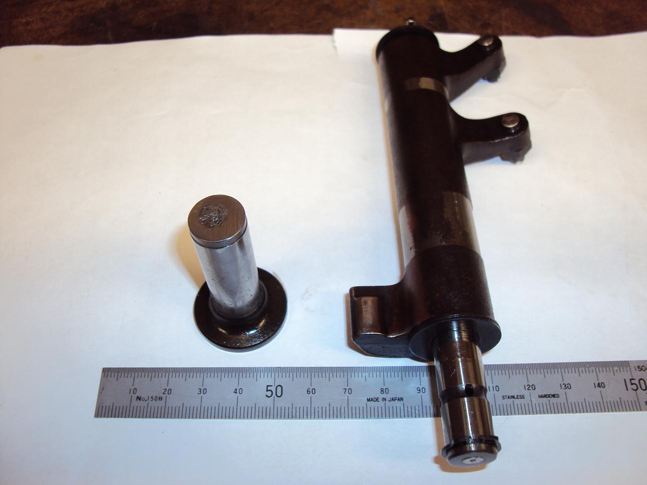

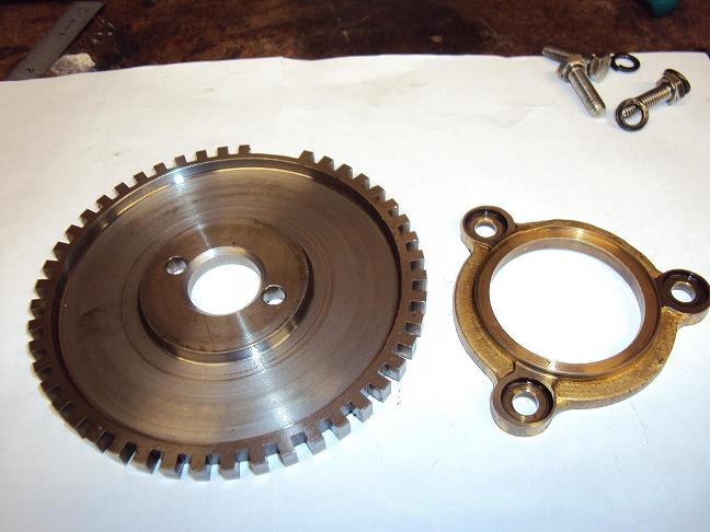

  11. Well as promised here is an update on the conversion so far.The Centauro engine has just arrived and I've stripped it down to the crank.It has a few issue to deal with. All lifters are shot and need replacing. One rocker pad worn where it bears on the lifter and will need rework or replacement. Cam drive gear is heavily worn Oil pump is actually not to bad and could could be reused,but I have a new aftermarket one on the way along with a set of Joe Caruso gears both cams scuffed but probably saveable.Why do Guzzi NOT have the cam oiling hole on the base circle of each cam lobe.Totally silly design. Cam tensioner pulleys both worn and req replacing The timing wheel has for some reason tried to chew its way through the cam retainer flange,requires replacement. Both cylinders worn,pistons are actually in good condition,ring end gaps around .42mm.Could run a flex hone through the bores and re ring it but would rather renew.Problem is getting piston/cylinder assy's.A business close to me will re nickasil the cylinders but its not cheap.Any contacts and options for cylinder and piston kits would be appreciated. Havent yet checked the valves for guide wear or pulled the crank.Will of course renew all the main and bigend bearings as a matter of course.Will also lighten and balance the crank significantly. The fun has just begun,this could take a while. Ciao
