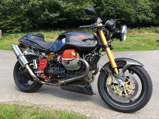

  19. Work in progress now has a frame mounted headlamp

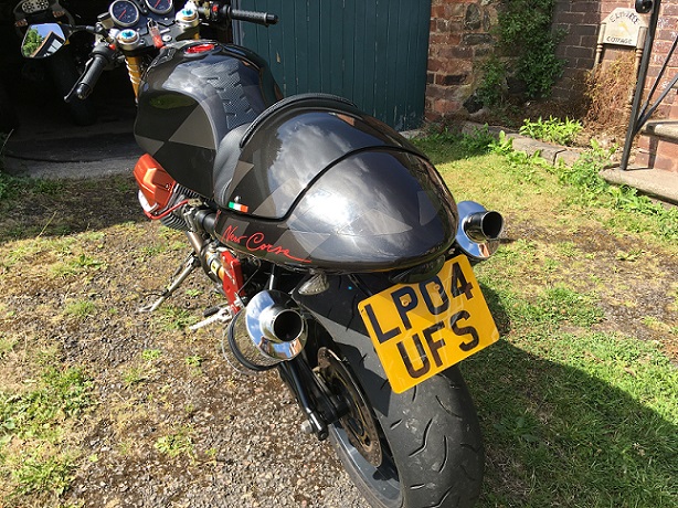

  21. Here's the bike with the new Delkevics fitted, great sound without the baffles installed, £89 each and available in the US I think

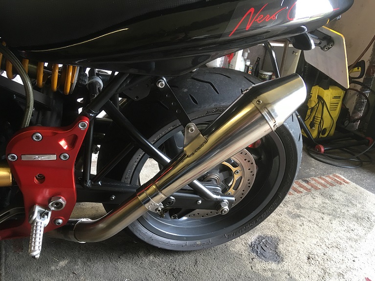

  24. As you can see from the photo 45 degrees works fine
