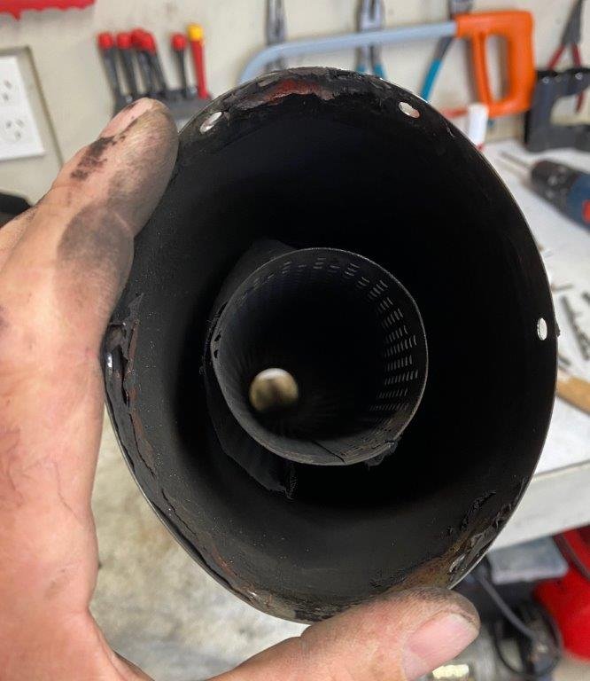

So then I thought I would attack the pipes to start the process of cleaning them up, removing dents etc. Interesting that it looked like one had already been opened and this is what I found inside.......no packing at all.
The other outlet end is very difficult to remove. It might have to stay there while I remove the dents which will make it a little bit harder.

I wouldn't recommend that for a few reasons. Firstly it will make dressing out the damage more difficult but more importantly it makes it impossible to wrap the perforated tube with woven glass/cloth which you need to do when re packing. It's not a good idea to just stuff glass wool down the can without the woven glass around the perforated section because the wool will blow out faster and the tiny loose wool fibres get sucked back into the cylinder on the overrun at the right revs. Not that it's going to do any real damage but best to avaoid that.

I  must not have been thinking today as I had that very thought when I was looking down the barrel when taking the photo. Its stuck pretty good. I don't want to add any more dings to the pipe trying to remove the end. I see there is a wrap around of fine mesh that must help keep the fibres from easily flying out........oh well I have time on my side. The original mufflers sound nice opened up but they must still weigh a ton!
