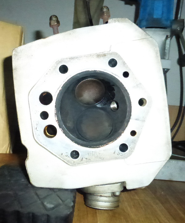

Lucky Phil Posted December 5, 2016 Share Posted December 5, 2016 The squish is 1,8mm, almost optimal value. Ok thanks, good to know. I'd prefer if it was around 1.2mm but 1.8 is better than what it must have been with the std composite gasket at 2.6mm if the metal one is 0.8 thinner. Really 2.6mm cant be considered a squish band at all, pretty much useless. A thinner base gasket will get it to the 1.2mm mark I'm sure. Ciao Link to comment Share on other sites More sharing options...

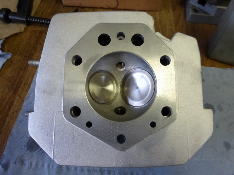

gelos Posted December 5, 2016 Share Posted December 5, 2016 Just so, I think the same. I´ve machined 0,7mm from cylinder head down face, the squish area is flat, not bevelled, CR rise about 11:1. And now is time to rebuild to double spark ignition. Before Link to comment Share on other sites More sharing options...
gelos Posted December 5, 2016 Share Posted December 5, 2016 And after rebuild 1 Link to comment Share on other sites More sharing options...
knumbnutz Posted December 9, 2016 Author Share Posted December 9, 2016 And after rebuild Thats sexy ! Link to comment Share on other sites More sharing options...
