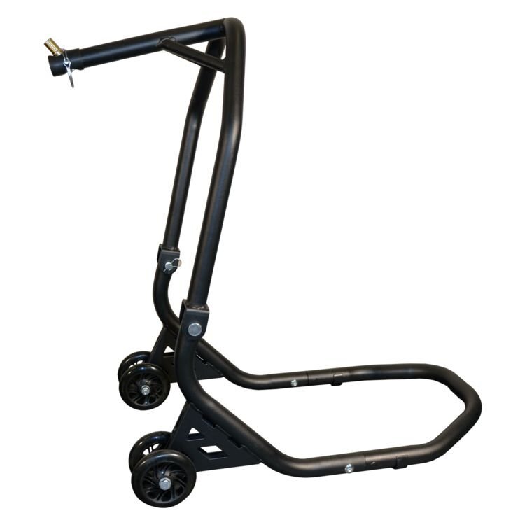

al_roethlisberger Posted February 1 Report Share Posted February 1 Has anyone confirmed any "head lift" style front stands that are compatible and work well with the V11 Sport or Lemans? I'm not a huge fan of the front stands that just have the two "fingers" that the ends of the forks sit in. Those seem less than secure... There are quite a few makes and models of head lift stands, but I just wondered if anyone found any that work well with the V11 Sport or Lemans geometry and fender. BTW, does anyone know: 1) If there is indeed an open hole in the bottom of the triple tree center head-tube for one of these head lift stand's pin to slip into? I should go look myself, but it's midnight and a cold and wet walk to the garage 2) If yes "there is a hole", then what the diameter of that hole is in mm? Again, I should go look myself, but see aforementioned time-check (I can always go look in the next day or two myself if no one knows) Attached is a photo of the type of stand I'm referring to as a "head lift" style. P.S. It really is too bad that AFAIK the rear swingarm of the V11 has no capability to mount lift spools, or does it? I've seen a number of adapters for other makes & models of motorcycles that allow spools to be mounted to the swingarm even if the swingarm doesn't have the threaded bushings for spools. Thanks. Link to comment Share on other sites More sharing options...
KINDOY2 Posted February 1 Report Share Posted February 1 I tried a few times on my V11's with the "Pit Bull" head lift stand that I have used on my Ducati's and Aprilia's..even with the right sized pin to fit inside the steering tube ..I couldn't see anyway it could be compatible with the front fairing and headlight, its too low and too far out for the Pit Bull stand to be able to fit under and back to the steering tube . I don't remember the pin size needed but its very small inner diameter compared to most bike..and I don't have a V'11 right now I can measure. 1 1 Link to comment Share on other sites More sharing options...

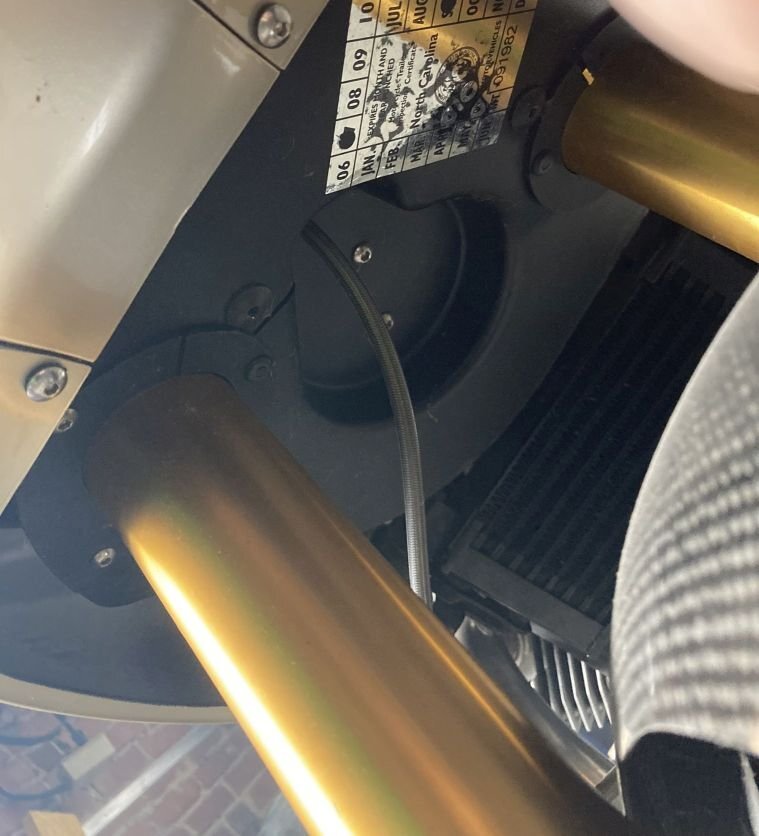

guzziart Posted February 1 Report Share Posted February 1 Yeah, swing arm spools would be great but don't know if it would be any easier for me than the "factory" style contraption that has me sweating every time I use it. My forks are up into the clamps about 8mm more than stock because of the hbar risers, I wonder if that is why it is a chore lifting up onto the stand??!! To aid in lifting my Lemans (and center stand bikes) I toss a 1"x6" under the rear tire, it helps. Plus the factory style stand allows a greater multitude of rear end tasks to be performed if needed vs. spools...imho Anyway, the headlift thing looks too for tire & fork oil changes. It won't work on '03 lemans, lower fork clamp is covered...some sort of air dam and not easily removable, brake line runs through it. Art 1 Link to comment Share on other sites More sharing options...
al_roethlisberger Posted February 1 Author Report Share Posted February 1 26 minutes ago, guzziart said: Yeah, swing arm spools would be great but don't know if it would be any easier for me than the "factory" style contraption that has me sweating every time I use it. My forks are up into the clamps about 8mm more than stock because of the hbar risers, I wonder if that is why it is a chore lifting up onto the stand??!! To aid in lifting my Lemans (and center stand bikes) I toss a 1"x6" under the rear tire, it helps. Plus the factory style stand allows a greater multitude of rear end tasks to be performed if needed vs. spools...imho Anyway, the headlift thing looks too for tire & fork oil changes. It won't work on '03 lemans, lower fork clamp is covered...some sort of air dam and not easily removable, brake line runs through it. Art I have the factory stand as well, and it works great... when it does But it's lift location also gets in the way of some tasks as well, so I've been thinking it would be great to also have the ability to lift via the swingarm. But of course our swingarms do not have spool bolt locations. However, I've noted a few "adapters" on the market such as linked below for the Honda Grom, which have a bracket that clamps around the swingarm that the spools are then mounted to. There aren't any of these adapters on the market specifically for the V11 Sport/Lemans, and I'm sure there never will be, but I think I'll go take some measurements of the V11 Sport/Lemans swingarm dimensions and reach out to some of these manufacturers to see what the dimensions are for theirs. If lucky perhaps one of these adapters could be used with the V11 Sport/Lemans swingarm. https://www.pit-bull.com/pit-bull-spool-adapter-kit-honda-grom-msx-125-f0125-000 And yep, the underside of the bottom triple is covered with a flat bit of fairing, but perhaps it could be drilled to allow a pin... noting the clearance issues pointed out by KINDOY2 above are still an obstacle. I suspect this would be another V11 R&D and testing project to find if a particular make & model of head lift stand might work and what special accommodations one would have to make to get it to actually work around a Lemans fairing, fender, etc. For example, perhaps a particular make & model of head lift might clear if the "chin" of the fairing were removed by removing its four bolts? Maybe I'll get that bit of fairing off this weekend, measure the hole in the head tube, and then see if there is an inexpensive lift to experiment with some time. Link to comment Share on other sites More sharing options...

gstallons Posted February 1 Report Share Posted February 1 I will look and see what the I.D. of the hole is and let you know . can that piece be removed from the stand and turned down ? Now , Pit Bull has a pin listed . P.N. / SKU # F0001-001 pin available. You could contact the Co. for dimensions ? Link to comment Share on other sites More sharing options...
gstallons Posted February 1 Report Share Posted February 1 I got 18mm i.d. on both bikes. 1 Link to comment Share on other sites More sharing options...

al_roethlisberger Posted February 2 Author Report Share Posted February 2 6 hours ago, gstallons said: I got 18mm i.d. on both bikes. It's probably safe to assume the ID for the Lemans is the same, but worth checking. I can't imagine why or how it could be different, but we've been surprised before. I'll try to measure that by this weekend while I'm out in the garage finishing cleaning up after neglecting the garage for about 2 years Several of the head lift stand brands either come with multiple sized pins, including 18mm, or also sell the different sized pins separately. So I don't think one would necessarily need to turn/mill a too-large pin down to size unless you needed a specific stand that for some reason didn't include the correct pin size, but that seems unlikely (I hope). Front Stand Head Lift – Vortex Racing Pit Bull indicates that the following model is compatible with "Moto Guzzi, Sport Models", so I've inquired if that translates to the V11 Sport/Lemans/etc series: Pit Bull - Hybrid Headlift - Motorcycle Front Stand [F0100A-000] (pit-bull.com) Link to comment Share on other sites More sharing options...
cash1000 Posted February 2 Report Share Posted February 2 I use a DRC stand. The 15mm pin fits my RM fine DRC B2510 Road Front Stemup Stand – Cycletreads It's the opposite here in New Zealand 30+ C. 2 Link to comment Share on other sites More sharing options...
al_roethlisberger Posted February 2 Author Report Share Posted February 2 12 hours ago, cash1000 said: I use a DRC stand. The 15mm pin fits my RM fine DRC B2510 Road Front Stemup Stand – Cycletreads It's the opposite here in New Zealand 30+ C. Excellent, thanks for the recommendation! One of us will have to give this or similar a try with the Lemans fairing. A quick Google looks like it is only available down under though? I'm hopeful that one of these will clear the "chin" of the Lemans fairing as-is, or worst case just remove that little "chin" panel from the fairing to make it work. And of course if one is doing major work on the Lemans, the fairing is likely off anyway, so that may be a moot issue in many cases. Link to comment Share on other sites More sharing options...

al_roethlisberger Posted February 2 Author Report Share Posted February 2 Here is a shot of the fairing piece on the Lemans that blocks the underside of the triple tree. One could just remove it when needing the stand, or maybe cut out the appropriately sized hole for the head-lift pin. Link to comment Share on other sites More sharing options...
