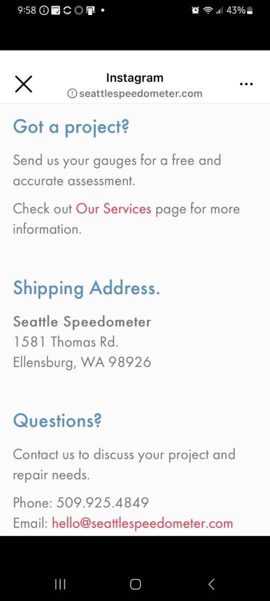

Tom in Virginia Posted February 15, 2024 Posted February 15, 2024 Word to the wise: I would not use Buzz at Seattle Speedo. I sent him two '03. LM gauges, about 4 years ago. He took forever to get them back. They exhibited very poor workmanship once I got them back, cracked, dirty (inside!), didn't work. I complained, he said send them back and he would correct. He didn't, worse the 2nd time. Its the only time I have ever felt like I got taken for ($$$) dealing with people/businesses on the internet. Read his one star Google reviews, I wasn't the only one. 1 1

Tom in Virginia Posted February 18, 2024 Posted February 18, 2024 On 2/14/2024 at 7:55 PM, p6x said: @Tom in Virginia Thanks for sharing! I am going to go with Casa di Moto which seems to have a good reputation. Hopefully, USPS is not going to lose the package. The UPS and FedEx prices are not making any sense... No problem. Think I paid Buzz at Seattle $586, not cheap, and especially since they were junk/trash when I got them back the 2nd time. I donated both gages to some guy in Canada for "an experiment" he wanted to try, rather than throw them in trash. I bought new ones (ODO in KPH) from Stein Dinse (for fraction of repair bill, roughly 140 each) 3
