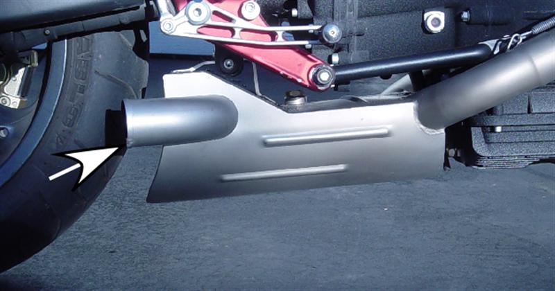

I just put one on at the end of this season. I'm planning to have a map made in the spring (~ May) and will post the results here if people are still interested.
I was running a Ferracci open air box mod + pipes + custom mapped PCIII and was happy except for scraping the mufflers on track days. That just scares the $@#$ out of me, so I bought a Quat-D (with the cat included) from Filippo at Firestarter Garage (great guy btw).

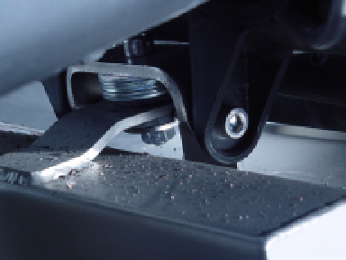

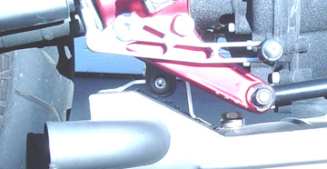

It needed a stack of washers to mount on my Sport Nekid - see the pic; I'm guessing the hanger is designed for an earlier model (mine's an 02 sold as 03).
The sound is pretty nice; a bit quieter than the Ferraccis, but still louder than stock. Somewhat metallic, but not enough to sound tinny.
My only complaint is that I scraped the exhaust pipe (arrow) in a right-hander the first ride out; on the street! I plan to cut it down or deform it to sort this out; I'd be interested in hearing from anyone that's done/contemplated this.
70366[/snapback]
I had the earlier muffler, and it is different.
70366[/snapback]
The washers don't look right. The pot has its back hanging, this looks not as I'd like it to look.
Do you think you could bend the front inlet tubes a bit, so that the back could come up to where it should be? The contour should follow the tire as well.

I agree that it would look better with the back raised and the bottom of the muffler parallel to the ground.
The front tubes are not the problem. The mounting brackets on the frame are the problem. They do not allow the muffer to be positioned any closer to the frame without cutting or grinding them down. I think this can be seen in the photo...
