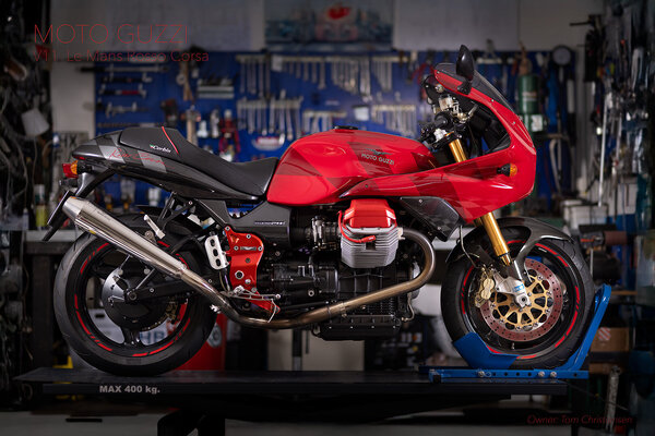

    Ebay V11

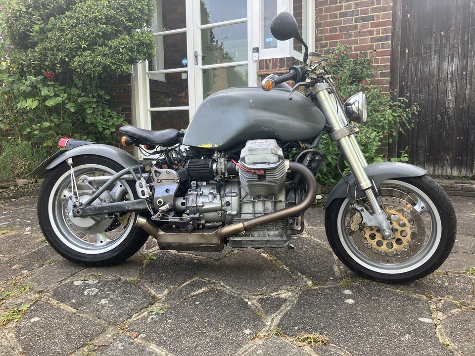

    As challenging as the V11 Sport/LeMans tank shape is to fathom whilst integrated with the rest of the original design, it is quite an abomination all by itself! Might as while mount up a Quat-D exhaust for "balance" . . . And the battery and the relays and the fuses and the ECU . . . oh, my!

  15. audiomick
    Ebay V11

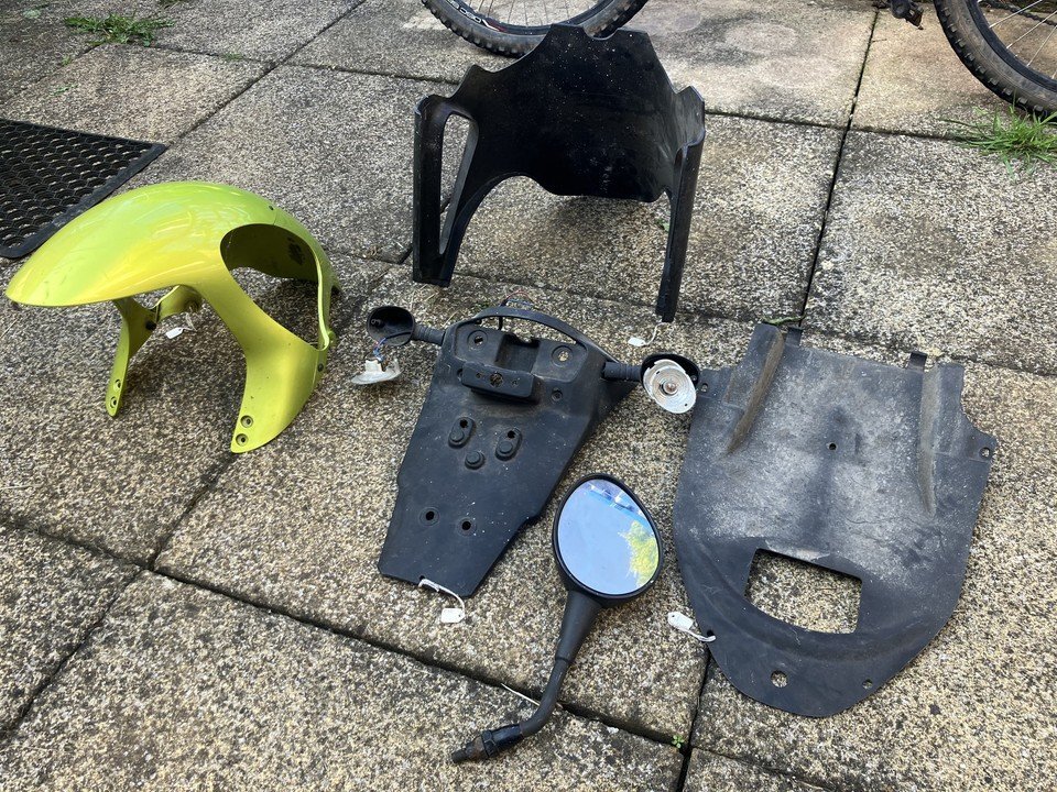

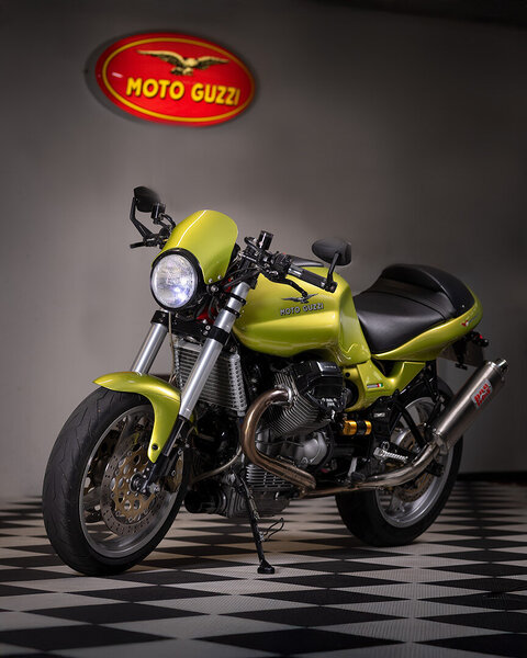

    Mate, yours is a gem. Here's some pictures for future generations who might read this after the ad has been taken down. The bike in question (one can actually see the green on the tank where the spray-can grey has worn off) and the seat sub-frame in red and a photo of parts showing the green front mud-guard.

  17. docc
    Ebay V11
    Makes me feel really good about what is left of mySport.
  18. audiomick
    Ebay V11
    I see the ad is "ended", and a further look at all the photos indicates that the poor thing was once a Greenie. One can only hope that she has been passed on to someone with enough decency to restore her to her former glory.

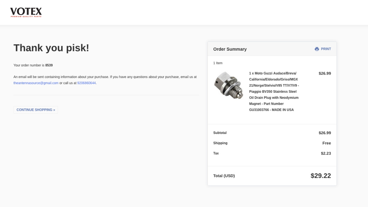

  19. The Neodymium magnet makes all the difference!!! Seriously, the Guzzi original one cost about 14 USD from the usual places. Then you need to also add the shipping. Here, they built the shipping into the price, so all in all, it's the same. The main difference, Votex has it in stock, while the others have to order it after you pay. Delivery in June! I want to fix that Quota as fast as possible.
