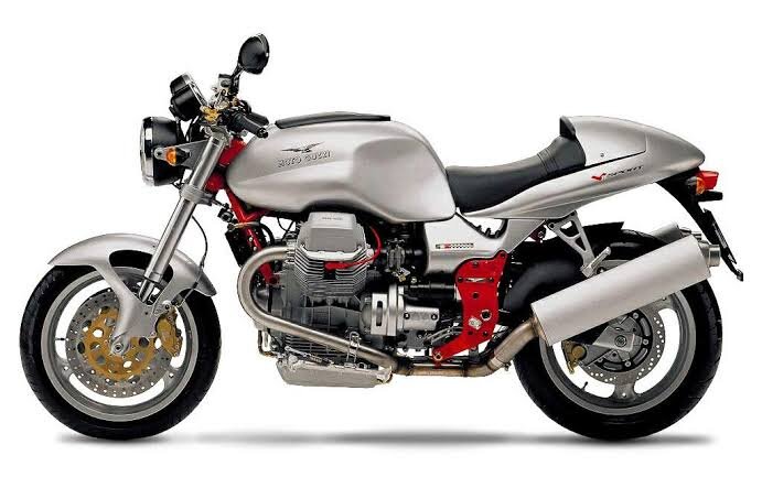

Here are a couple of the bikes that get my juices flowing. (I prefer my bikes to have the same colour paint on all the plastics. Different colour tanks, side covers, seat cowlings etc, just looks to me like they ran out of matching colour components at the factory, so they just stuck whatever was lying around on the bike.)
So what is the best

Really interesting to ponder (of the V11 series) "So, what is best?"
Many would naturally select the models with Öhlins suspension, yet I've heard it said that the Guzzi spec Öhlins is not really up to what we might expect from that esteemed maker. Plus, Öhlins was never offered on the ShortFrames (my preference) and only came on handlebar V11 with the stand-off headlamp/instrument mounting or the Corsas with the sad tank decal failures.
Then there is the matter of full faring, bikini fairing or nekkid. Lately, I been diggin' nekkid, but that may be sharing too much. :huh:
So, @Calijackalbob , best monochromatic (Designer Marabese would heartily approve! :sun:) might well be the 2003-2004 black or red LeMans if you're in for the full faring and willing to set up the suspension.
If you can tolerate the stand-off headlamp/instrument mounting and like the bikini/flyscreen then it is, hands down, the 2005 Scura R. :food:
