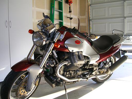

    "These have rubber intakes like the later V11? TBs that squeek make me think of an intake leak . . " OK, the right throttle body rubber intake cover does have little cracked lines all over it. The left side rubber does not. Can I tell if it's leaking by spraying water over it while running?

    back to that TB noise - stumble -- before I go hooking up my twin max and start fooling with this thing - can I gete some advice here? -- at idle all seems fine at about 1200 rpm- perfect with no hiccups. Then giving it a little throttle, I can see the right throttle body butterfly open slightly, I hear a sqeak coming from the TB (?) and then rpm's drop. My solution while out is to increase throttle rpm's which to me is overtaxing the engine and can't be too good for the clutch either! What do you think? TB balance and tps setting?

    you're right edge of the wil creedon chip - guy's beast had it for sure -- and it does run great. It just stumbles, especially when cold - the throttle skips and maybe there's too much throttle play in the linkage maybe-- when cold especially, when rolling the throttle slightly on, there's a squeak sound in the throttle linkage, a stumble, then it catches and all is fine thereafter. on the pipes, I'm going to have them jet coated with their silver, nickel look. And even though the current veluchi (? I can't spell) bars fit me perfectly and the bike handles beautifully with them, I like the look of the OEM bars - I've got them ordered...... the whole bike seems sooooo stable too. I almost forgot -=- had to add this edit while in Alaska too -- the gearbox -- 5 speed and silky smooth. Man oh man. Haven't heard a clunk yet. speaking of alaska -- been in jeauno (can't spell), skaqway, ketchakan - no guzzi's yet -- seen quite a few adventure tourers however. One guy I met at the top of whitehorse pass - he'd been to Nome (!) on a honda all purpose tourer.
