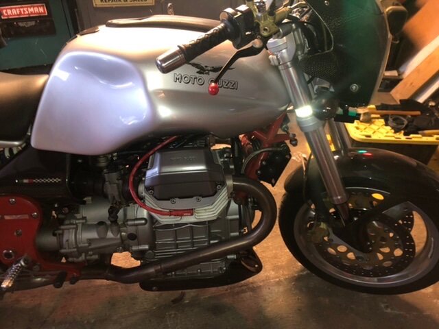

  3. Thanks, I was trying to mimic the titanium color scheme. My engine is a transplant from a California EV Titanium so in a sense it is the original valve cover color that came on that engine. They were looking a bit second hand so I had to refinish them.
  4. Well I did this color change with a spare set of valve covers. I like it… what about y’all.

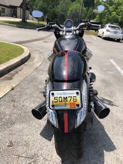

  5. Well here is my personal review of the MIVV cans on a V11 sport. The MIVVs sound amazing. They make the V11 sound exactly what I always wished it would sound like ! Very vocal yes, they talk the talk yet at highway cruising speeds they mind their manors. And the tone is so nice. I’ve had riding buddy’s comment that they sound almost like a musical instrument. The style, build quality, and price are all “on point”. I love um.

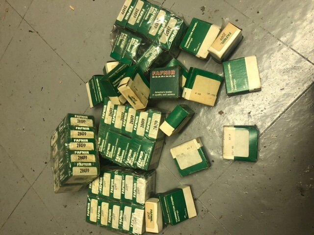

  6. I did some maintenance on my 2001 V11 sport today. I pulled the rear drive off to inspect bearings for the most part and found the (outboard?) needle bearing was in need of attention. It was full of rock hard, dried up grease. It’s grease seal was also in bad shape. I don’t believe it has worked as a roller bearing for years. I disassembled it and cleaned it, repacked it with grease, and put it back into service but I’ll be ordering a new bearing for later. I replaced the wheel bearings as well. Easy task once you have the wheel off ! The front wheel bearings failed years ago so I suspected the rears needed replacement by now, 49,000 miles. Otherwise the rear drive felt nice, looked nice. On a lighter note, If anyone is need of a wheel bearing while traveling through Kentucky, I’ve got your back. I have extras 😜
