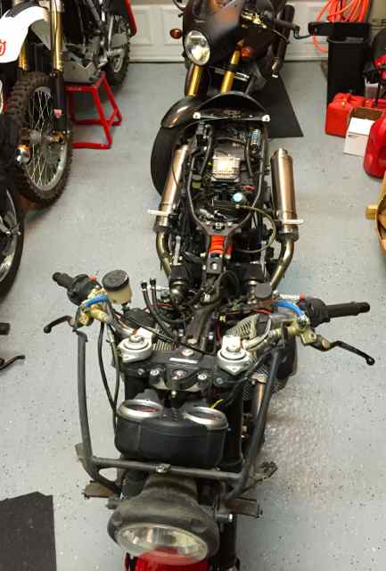

Robin Trower and I stripped the bike a bit this evening to get it ready for a deep-cleaning and new gauges. Also flushed the nasty front brake fluid. BTW - I've read a number of posts in which people mention how hard it is to remove the quick-connectors from the 2003+ fuel tank. I found that an 8 or 9 mm open-end wrench fits over the tube and provides enough leverage to get the connector moving. Easy-peasy, hope it helps. Also dropped by the powder coater at lunch time to pick up several powder coated sample washers in interesting possible colors....... I like one that is about the same grayish-bronze as the Moto Guzzi logo on the tank. That could work for a bunch of small parts.

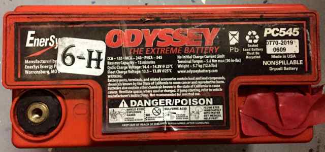

First little batch of questions: The bike has an Odyssey drycell battery. I know it's supposed to have an AGM type of battery. Is this drycell OK to keep in there for a while longer or is it likely to cause problems? I need a few parts that I have not been able to find. I already posted this in the classifieds/wanted. But if anyone has one of these items or knows where I can find a used one, I'd be much obliged: Gear shift lever and pivot bolt (through porkchop, through lever, to tab on frame). The lever I have was welded and the pivot bolt is slightly bent so it won't thread back into the frame-tab correctly. (I did find a billet lever for $159 at Harper Moto) Rear brake lever return stopper - the cylindrical bit that keeps the brake pedal from bouncing up. Sidestand - ideally with switch and wire, but just the stand is fine too. The sidestand on the bike was shortened a bit and I'm concerned it will lean too far when I restore the original ride height. Clutch hand lever - (I know I can get a new one from MG Cycle) Left-hand handlebar tube - for clip-ons. Also feel free to post links if you know where to purchase any of these items. Edit - all parts procured.
