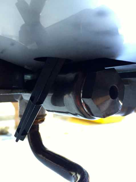

To remove shift lever: Disconnect shift linkage from lever. Remove nut from the end of the pivot bolt - this is the "trick" - the pivot bolt goes through the "shield" (aka porkchop) to a tab on the frame. The pivot bolt threads into that tab, then a nut goes over the end of the pivot bolt's exposed threads to lock it in place. I used a socket on a long extension with a u-joint to access it from the RH side - all the way through the bike. Once the retaining nut is off, the rest is easy. Then remove the pivot bolt (allen wrench) and the shift lever will slide right out.
