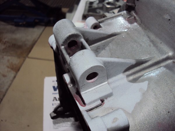

Lucky Phil Posted April 22, 2020 Report Share Posted April 22, 2020 On 4/22/2020 at 2:25 AM, hammershaug said: No information or photos on the website... Can you tell me more about the transmission bracket? Yes, I have searched the forum with no luck. Thanks! [LuckyPhil said]: Look at my V11 Daytona project thread. Lots of info on gearbox cracking there. Ciao _________________________________________________________________________________________________ [LowRyter said]: If you have a red ( and some black ) frame bikes , there is a shop that make them . Motiv Cycle Works . 906 N. Ann Arbor Ave . Oklahoma City , Ok. 73127 _____________________________________________________________________________________________ [Kane said]: She’s a lovely steed! Looking forward hearing about you and your Greenie! When was that picture taken? ______________________________________________________________________________________________ [hammershaug said]: Thanks, Kane, and welcome to my spot. I took the picture on September 1, 2019. ______________________________________________________________________________________________ Cheers! That’s a great photo album. Such cool rides. Beautiful landscapes! ______________________________________________________________________________________________ On 4/21/2020 at 12:11 PM, hammershaug said: Hello, V11 aficionados! This thread is about me and my Greenie. Good days and bad days. A steep learning curve, maintenance, and later on some tuning and styling. I bought the '00 V11 Greenie on the last day of August 2019. A friend drove me from Gausdal to Stryn, and I drove home on the bike. My first trip on a Guzzi since I sold the V65 Lario in 1995. 300 km in cold weather, rain, and sun. I enjoyed every moment, every curve. [swooshdave said]: I bet that was a shocking ride compared to the V65! Can you tell us more about the trip? Did you take pictures? ___________________________________________________________________________________________________________________ [hammershaug said]: Finally, I got time to do some work in the basement. Took down the sump and filter. Cleaned it. Ripped off headers and crossover. Removed the air filter box and the worn intake rubbers. Tomorrow I will remove both throttle bodies. The rubber hoses on both sides of the throttle bodies will be replaced. Then I am thinking about putting the throttle bodies in my ultrasonic cleaner... Is that a good idea? On 4/21/2020 at 3:40 PM, swooshdave said: I bet that was a shocking ride compared to the V65! Can you tell us more about the trip? Did you take pictures? [hammershaug said]: You bet! Very powerful compared to my Lario, and my 1953 Husqvarna:) I think I have one or two few photos. _______________________________________________________________________________________________ On 4/21/2020 at 3:50 PM, hammershaug said: Finally, I got time to do some work in the basement. Took down the sump and filter. Cleaned it. Ripped off headers and crossover. Removed the air filter box and the worn intake rubbers. Tomorrow I will remove both throttle bodies. The rubber hoses on both sides of the throttle bodies will be replaced. Then I am thinking about putting the throttle bodies in my ultrasonic cleaner... Is that a good idea? [LuckyPhil said]: To do that you should probably remove the injectors. Personally there's no real need to ultrasonic them as everything can be easily accessed with the simple traditional methods. So throttle plates and the bores and the air bleed screws and passages etc. I have a large ultrasonic cleaner bath that will fit throttle bodies and I didnt do mine. If I was going to totally strip them I would but otherwise no need I think. Oh and believe me throttle bodies arent easy to strip. I just did a set for a Ducati and its virtually impossible without ruining a lot of fasteners. Weber put them together with red loctite. My advice is dont remove anything from them unless its absolutely necessary. Ciao _______________________________________________________________________________________________________________________________- [gstallons said]: I think there are things in the throttle bodies that don't need that kind of treatment . ________________________________________________________________________________________________________________________________ [LowRyter said]: You might get the transmission bracket that attaches to the frame. It the keeps the gearbox housing from cracking. You want it for a redframe. My guy at Motiv in OKC can sell you the bracket and fasteners. He sells kits, you might find a factory piece but hardly available. http://www.motivcycleworks.com/ _________________________________________________________________________________________________________________________________ On 4/21/2020 at 8:54 PM, LowRyter said: You might get the transmission bracket that attaches to the frame. It the keeps the gearbox housing from cracking. You want it for a redframe. My guy at Motiv in OKC can sell you the bracket and fasteners. He sells kits, you might find a factory piece but hardly available. http://www.motivcycleworks.com/ [LuckyPhil said]: May as well check the gearbox mount as well Ciao ________________________________________________________________________________________________________________________________ On 4/21/2020 at 8:54 PM, LowRyter said: You might get the transmission bracket that attaches to the frame. It the keeps the gearbox housing from cracking. You want it for a redframe. My guy at Motiv in OKC can sell you the bracket and fasteners. He sells kits, you might find a factory piece but hardly available. http://www.motivcycleworks.com/ [hammershaug said]: Thanks for the tip! I will check that out. ___________________________________________________________________________________________________________________________ On 4/21/2020 at 5:58 PM, Lucky Phil said: To do that you should probably remove the injectors. Personally there's no real need to ultrasonic them as everything can be easily accessed with the simple traditional methods. So throttle plates and the bores and the air bleed screws and passages etc. I have a large ultrasonic cleaner bath that will fit throttle bodies and I didnt do mine. If I was going to totally strip them I would but otherwise no need I think. Oh and believe me throttle bodies arent easy to strip. I just did a set for a Ducati and its virtually impossible without ruining a lot of fasteners. Weber put them together with red loctite. My advice is dont remove anything from them unless its absolutely necessary. Ciao [hammershaug said]: I will definitely not strip the bodies. I can't see any harm to try USC. As long as my precious vinyl tolerates the treatment, why not a throttle body? Don't you think? On 4/21/2020 at 8:54 PM, LowRyter said: You might get the transmission bracket that attaches to the frame. It the keeps the gearbox housing from cracking. You want it for a redframe. My guy at Motiv in OKC can sell you the bracket and fasteners. He sells kits, you might find a factory piece but hardly available. http://www.motivcycleworks.com/ [hammershaug said]: No information or photos on the website... Can you tell me more about the transmission bracket? Yes, I have searched the forum with no luck. Thanks! 5 1 Link to comment Share on other sites More sharing options...
