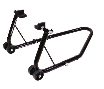

GuzziMoto Posted December 1, 2022 Report Share Posted December 1, 2022 There isn't anything special about a Guzzi as far as stands go. There is that model specific stand that Guzzi sold, I believe they called it a central stand. Item #6 in the parts catalog under Tools Not sure if you can still get that workshop stand. But most any generic stands will work. Some stands require bobbins be added to the rear swing arm, that requires additional work. But a stand that just uses rubber coated wings to pick up the rear swing arm, like this one, will work. https://www.cyclegear.com/accessories/oxford-big-black-bike-rear-stand?sku_id=978434 That one is just a cheap stand, not one I specifically use. The ones I use are old and no longer sold. If I were buying one today I would probably buy a stand from PitBull, as they are a quality brand. But they are twice what a cheapy stand will cost you. On the bright side, not only are they better designed and built than the cheapy stands but they are modular so you can upgrade it later to spools if you add spools to the swing arm. Spools will be more secure. 3 Link to comment Share on other sites More sharing options...
