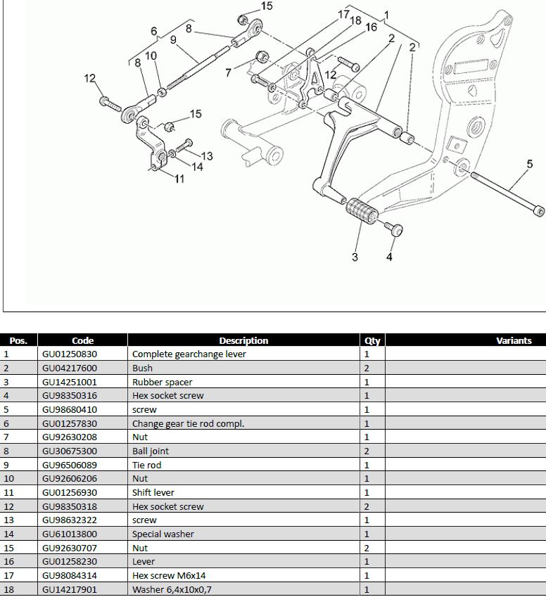

MartyNZ Posted August 30, 2016 Report Share Posted August 30, 2016 That some of the foot levers have different appearances (protruding bushing) is no false alarm. There are two lower-rear subframe versions (late model long-frame has braced subframes). Do any of the late models index the protruding bushing into the subframe tab? On my bike, the bush protrudes from the foot pedal lever (item 1), and just fits into the hole in the pushrod drive lever (16). That lever (16), that Chuck is making, has the rear lower hole the same size as the bush (2) OD, not the pivot bolt (5) OD. At least that's what I'm expecting when the slow boat from California arrives, and that's what Chuck's CAD drawing seems to show. And Chuck's picture in post #18 of this topic.I made new bushes (2) for my Pedal Lever, and I expected to be able to drive them further in, as Docc suggested, and trim them off later, but no. The counterbore for the outboard bush was about 10mm for a 10mm long bush. At the inboard side, the counterbore was about 8mm for the 10mm bush. The bush on that side is designed to protrude, but not enough to touch the subframe tab. Link to comment Share on other sites More sharing options...
Lucky Phil Posted August 30, 2016 Report Share Posted August 30, 2016 That some of the foot levers have different appearances (protruding bushing) is no false alarm. There are two lower-rear subframe versions (late model long-frame has braced subframes). Do any of the late models index the protruding bushing into the subframe tab? On my bike, the bush protrudes from the foot pedal lever (item 1), and just fits into the hole in the pushrod drive lever (16). That lever (16), that Chuck is making, has the rear lower hole the same size as the bush (2) OD, not the pivot bolt (5) OD. At least that's what I'm expecting when the slow boat from California arrives, and that's what Chuck's CAD drawing seems to show.I made new bushes (2) for my Pedal Lever, and I expected to be able to drive them further in, as Docc suggested, and trim them off later, but no. The counterbore for the outboard bush was about 10mm for a 10mm long bush. At the inboard side, the counterbore was about 8mm for the 10mm bush. The bush is designed to protrude. V11 Shift Lever.jpg This is correct from my experience. I did the same, made new bushes and modified the bolt so the threads didn't destroy the inner bush. Ciao 1 Link to comment Share on other sites More sharing options...
