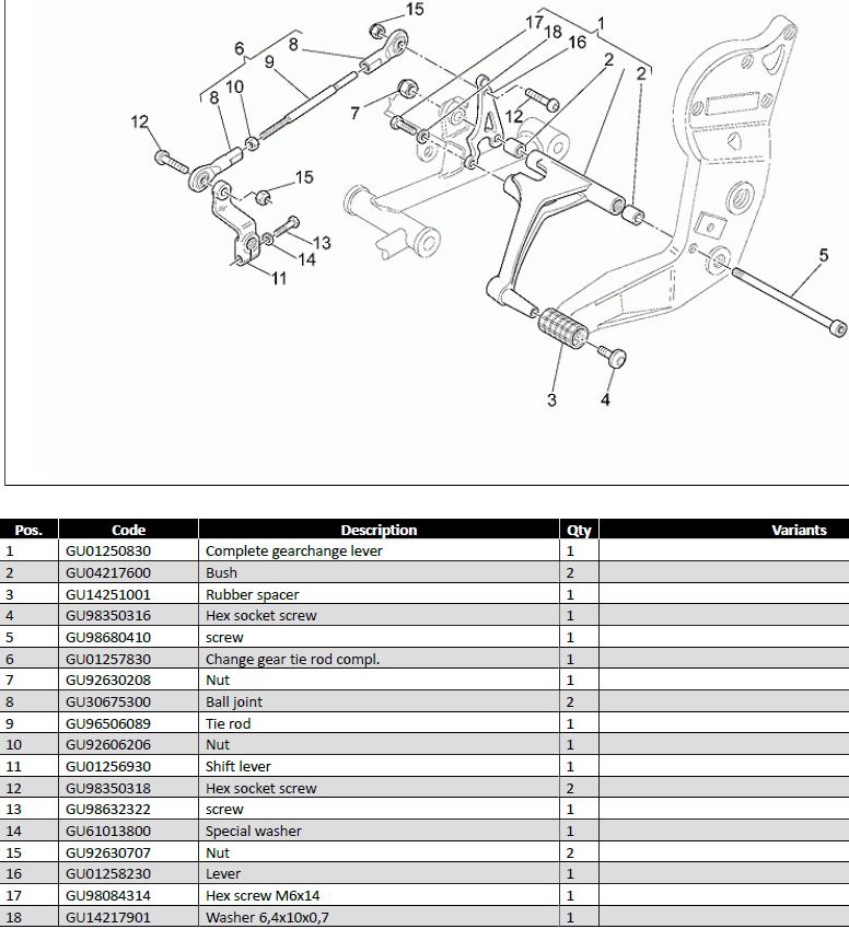

MartyNZ Posted August 30, 2016 Report Share Posted August 30, 2016 Hmmm... I just looked up the gearshift lever for 1999, 2002, and 2003 on Harper's website. The part numbers are the same (01250830) for all three. I agree Tim. On my shift lever, the bush (item 2 in the picture) protruded out of the inner face, but is flush on the outer face. Link to comment Share on other sites More sharing options...
docc Posted August 30, 2016 Report Share Posted August 30, 2016 Do the part numbers change for #16 : "lever?" Or should those bushes simply be pressed back in? Link to comment Share on other sites More sharing options...
Scud Posted August 30, 2016 Report Share Posted August 30, 2016 Do the part numbers change for #16 : "lever?" Or should those bushes simply be pressed back in? Oh - you mean I should compare the part numbers for the actual part we are talking about. Brilliant! The part number is same in the 1999, 2002, and 2004 diagrams at Harpers: 01258230 Sorry for the false alarm. Scud Link to comment Share on other sites More sharing options...
docc Posted August 30, 2016 Report Share Posted August 30, 2016 That some of the foot levers have different appearances (protruding bushing) is no false alarm. There are two lower-rear subframe versions (late model long-frame has braced subframes). Do any of the late models index the protruding bushing into the subframe tab? Link to comment Share on other sites More sharing options...
