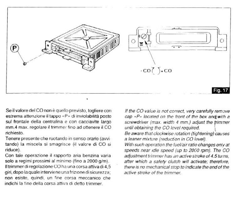

antmanbee Posted April 23, 2019 Share Posted April 23, 2019 These are the instructions for the CO trim pot. I have read different things about the pot. Some say you can damage it by rotating too far others not. If you hook up Guzzidiag it will tell you if you are at zero or plus or minus. I adjusted mine by going half way between the far left and right and then later when I hooked up Guzzidiag I was almost perfect. But you can just get it close and adjust a little bit one way or the other by how the bike runs. Link to comment Share on other sites More sharing options...
antmanbee Posted April 23, 2019 Share Posted April 23, 2019 Almost near the bottom of this page is some more info on the P8 CO adjustment. The whole page is a good how-to for TPS and throttle body set up. Use the Meinolf setting of .157 for the TPS instead of bradthebikeboys .150V. http://bradthebikeboy.blogspot.com/2012/10/throttle-position-sensor-setting_21.html Link to comment Share on other sites More sharing options...
