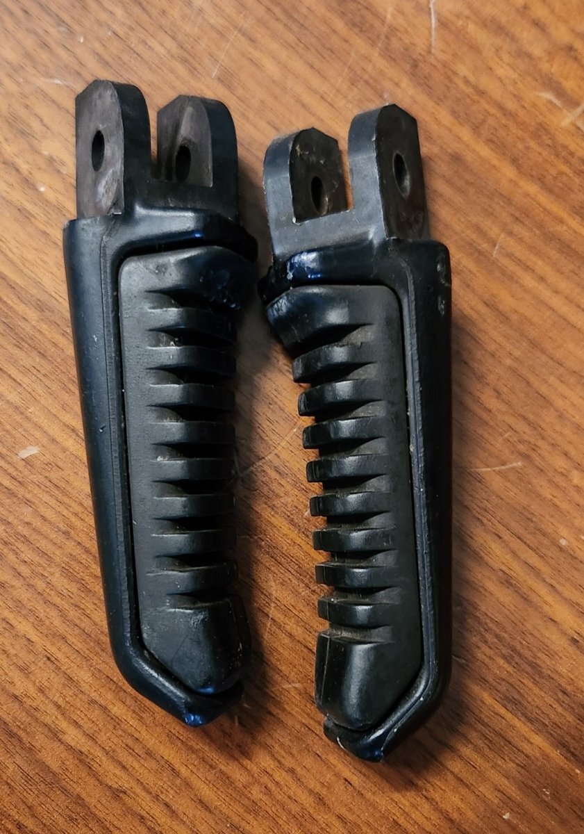

I was on a fly and ride home from Maryland when I was taken out by a pickup driving out of a parking lot right in front of me. Thankfully hit him at pretty low speed leaned over to the right and no paint of plastics damaged just some parts. What I'm looking for now is a right side front footpeg. They seem to be total unaobtanium now. Does anyone out there have one they'd be willing to part with? Feel free to PM me if you can help me out.
Thanks.
  • Like 3
I think I saved mine from when i converted to Knight lowered pegs. Just have to find them. Their yours for $1 million dollars (cue Dr. Evil). Or possibly free + shipping...
  • Haha 1

4corsa let me know if you find them!
I believe this is what you're looking for. Just have to figure out which is left or right, and will send to you, just let me know your address.
