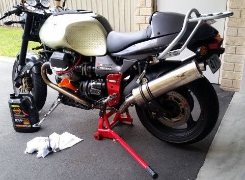

cash1000 Posted May 10, 2022 Share Posted May 10, 2022 Or you could make your own factory stand or MartyNZ has an even better one that he might like to show here 2 Link to comment Share on other sites More sharing options...
cash1000 Posted May 10, 2022 Share Posted May 10, 2022 Just now, cash1000 said: Or you could make your own factory stand or MartyNZ has an even better one that he might like to show here Another Photo 1 1 Link to comment Share on other sites More sharing options...
Lucky Phil Posted May 10, 2022 Share Posted May 10, 2022 3 hours ago, cash1000 said: Another Photo Yes I got an almost identical one when I bought my bike, Damaged paint to the pork chops and dangerous as hell to use, with the bike moving backwards about 6 inches as it rolls onto the stand. You were also unsighted to one of the nut supports when using it and hoped it hadn't moved out of position as you moved the bike upright and got it settled. It was so dodgy I stopped using it. Anyone that wants it can have it for nothing. The beauty of the socket type with wheels is the stand stays captive on the mount nuts so the stand can't disconnect from the bike and the stand rotates safely and controllable under the bike on its own wheels. It also means you can roll the bike into a front wheel chock so it's vertical and lift the rear of the bike while in the chock. For the sake of $150 or so the other type isn't worth the risk. Ciao 1 Link to comment Share on other sites More sharing options...
MartyNZ Posted May 10, 2022 Share Posted May 10, 2022 5 hours ago, cash1000 said: Or you could make your own factory stand or MartyNZ has an even better one that he might like to show here I looked at Cash1000's stand, and thought I could make one like it, but red, and with wheels. It has plastic clevises to avoid marking the pork-chops. 4 Link to comment Share on other sites More sharing options...
