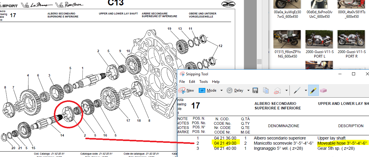

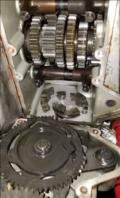

docc Posted November 16, 2022 Share Posted November 16, 2022 On 11/16/2022 at 10:04 AM, Twin AH said: Hey Doc Just curious if those machines in question might have tell tale sealant visible on the trans/engine cases if they have been done? Thoughts Ciao On 11/16/2022 at 11:41 AM, gstallons said: "maybe" ...... Exactly. I can only think of a couple people who could say how it is possible to visually verify the status of this recall work. Guys that actually performed these recalls back in 2004-2005 . . . @LeMaynes has shown us what we do not want . . . And the "hose couplings": 3 Link to comment Share on other sites More sharing options...
docc Posted November 18, 2022 Share Posted November 18, 2022 "Manicotto Scorrevole" . . . "sliding sleeves" (makes sense for what we were calling "sliding dogs." Instead, "flexible hose coupling " refers to the other part of the recall, the gearbox "cushdrive" : 1 Link to comment Share on other sites More sharing options...
docc Posted November 18, 2022 Share Posted November 18, 2022 Okay, yes: #16 = 04211201001 "Flexible coupling hose kit " (2 parts, not the washer stack/#18) And two "Sliding Sleeves" (#2 in this diagram): 1 1 Link to comment Share on other sites More sharing options...
