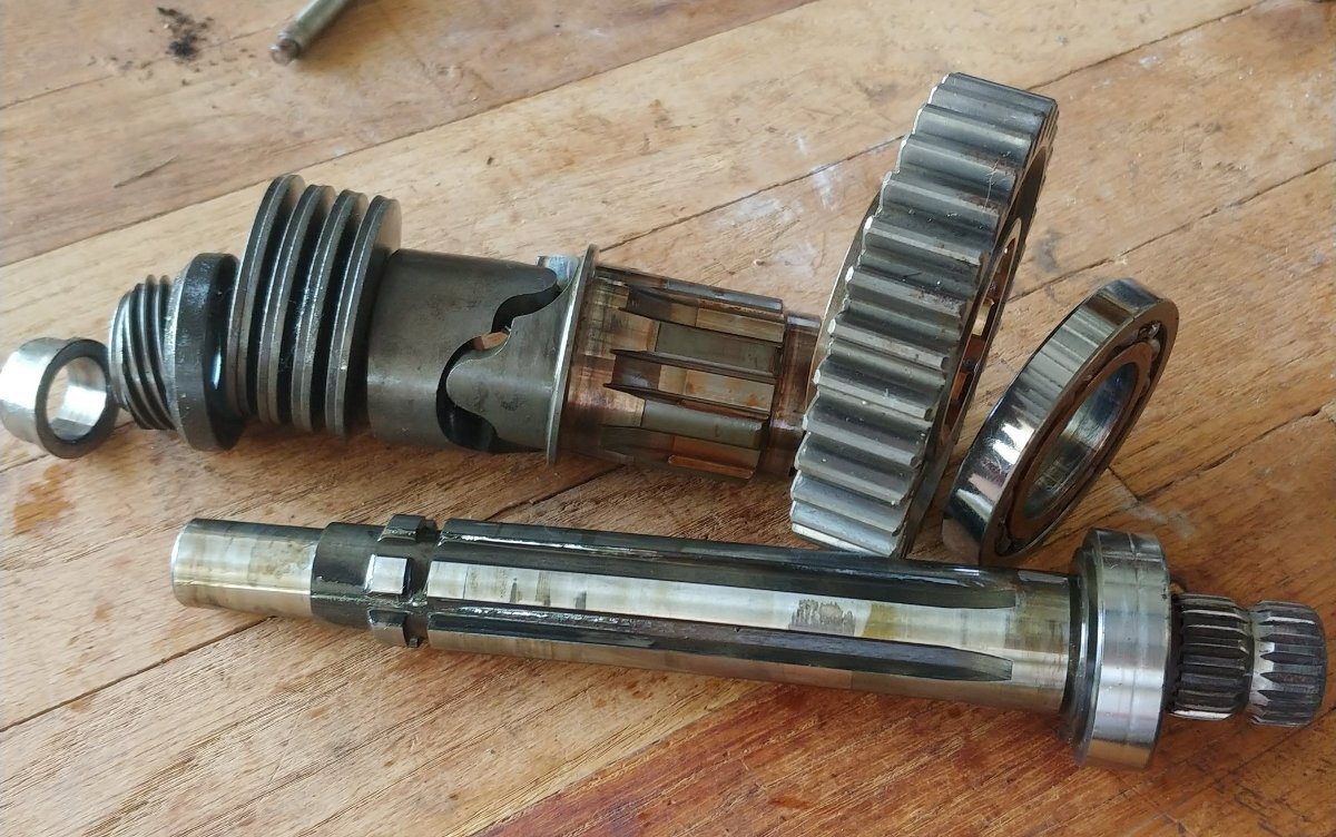

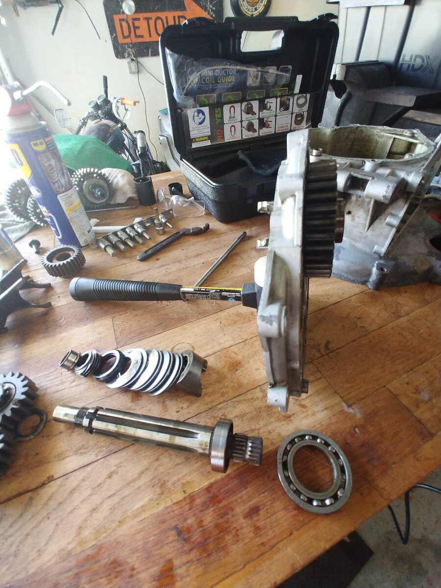

So, bearing race came off, with a little learning curve on the new inductive heater- it comes with an insulating wrap specifically for bearing races. It doesn't say why, other than that the coil used for races isn't preformed and I assume it is so you can use it on any size, and the insulator keeps the coil cover from burning. With 3 wraps and the insulator, I had to go back 4 times, the last time being for 25 seconds plus whatever heat was in it beforehand. Here's what it looks like apart, with everything in order of assembly (the compensator ramp and gear in the case simply slide apart as well) The bearing in question is on the right, trapped by everything between it and the end race on the left.
