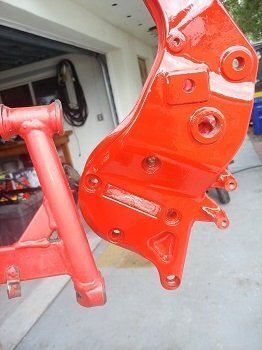

  10. Cameras. Huh. The pics really don't show what the eye sees here, but. The stock porkchops have turned a shade of purple south of red, noticeably darker than the frame. I bought a set of porkchops from TLM to get the swingarm pivot pins, and they were nicer overall so I cleaned them up and painted them to swap on. I found red caliper paint, much more durable than regular enamel, to be a pretty good match; again the camera doesn't really show the shade well, given the stock trans mount has the sheen off due to age and cleaning, the porkchops not yet dry. I think they'll end up very close, perhaps a half tone brighter and certainly shinier than the frame- though I did paint the front engine mount so most of what you can see will be the same.

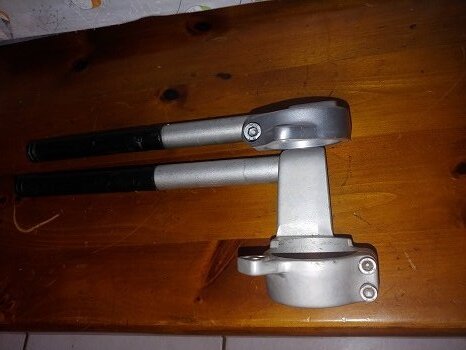

  13. Before I found the stock bar mounts in a box labelled "SV Parts" I bought the Ballabio mounts from the bike with forks discussed above. Looks like the Ballabio mounts go above the top tree, rather than under it? Can anyone say if the top tree is the same, and how much difference in height between the two setups? I think I have the bars stuck in backward but it's reversible. I promise to get it right.

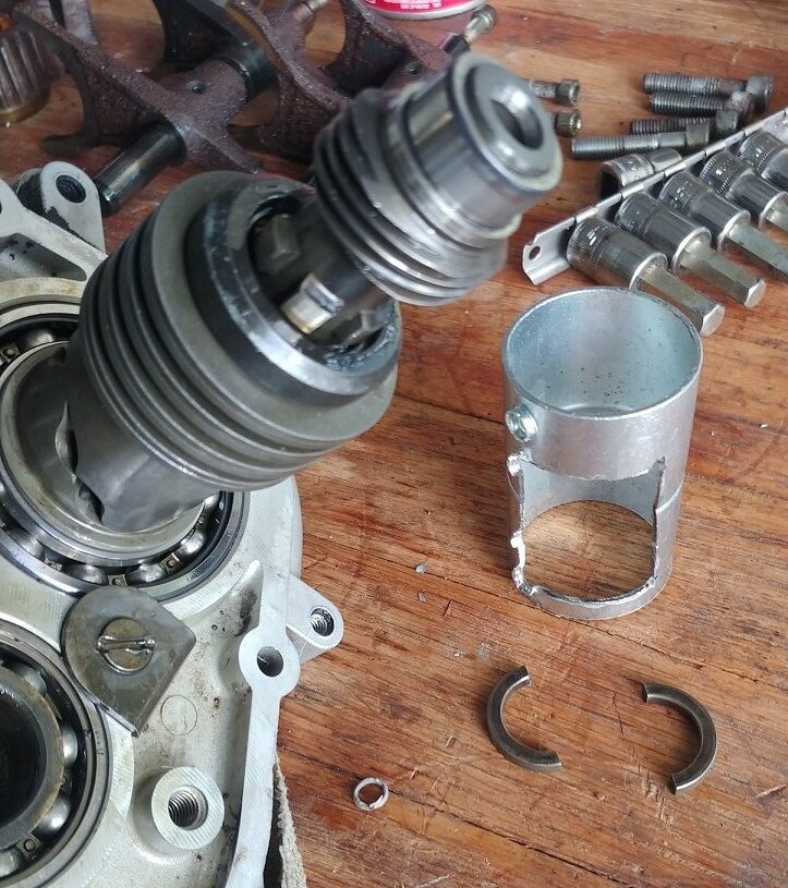

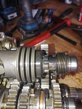

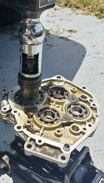

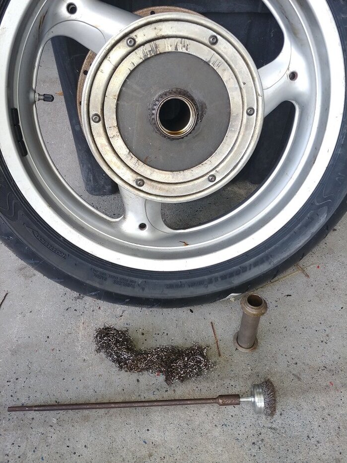

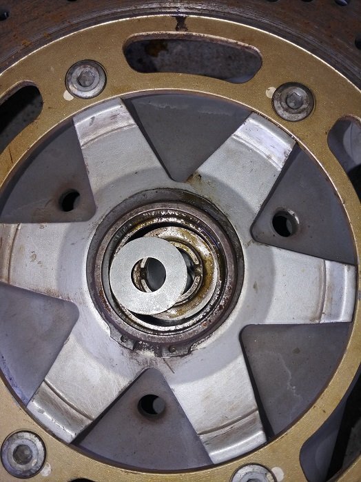

  15. Wheel bearings today. Rears were original, spacer was a bit short to make me happy with the new bearings, so tossed in a .75mm valve spring shim. Can move spacer slightly with fingers, pushing in on bearing races tightens spacer. Nice. Pic shown is an easy compare between spacer length and hub shoulder; the washer, when slid around on the spacer, just whisks the bearing shoulder. Needs a bit of clearance not to be tight when assembled. To measure, Phil's way, the spacer is about .005"-.010" short. About +.010" long with shim. The inside of the rear hub was just as nasty as the inside of the drive box, so the hub and spacer got a nice rubdown and again, cosmoline is your best friend. Front bearings, one had been replaced; buggers were TIGHT coming out so much I wondered if I misunderstood what was going on with the spacer. A little cleanup in the bores and a touch of cosmoline and the new ones went in... less tight. Much tighter than the rears.

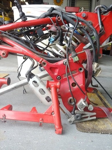

  18. Every time I touch this thing it comes further apart and costs more lol Well, the frame's off the motor now, as it was the front engine mount that needs the paint...I do get the brother-in-law deal at the painter but I was more thinking 'automotive engine enamel fire engine red'. <sigh> I was waiting to decide on the bodywork until it was mechanically sound, but maybe I'll just pack it up and take it all tomorrow.
