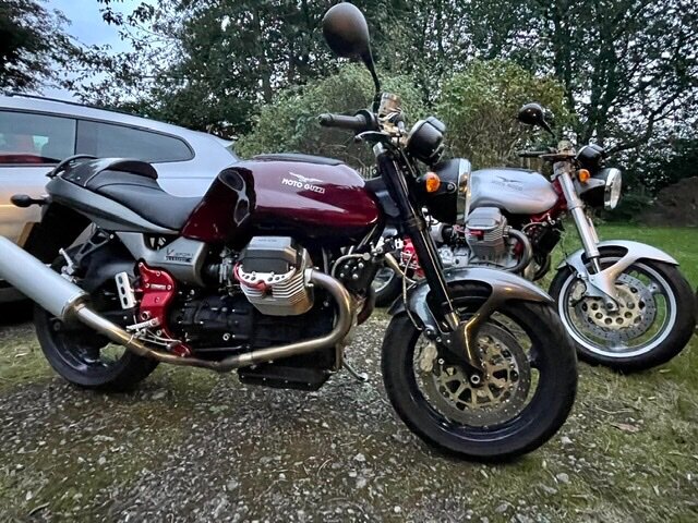

Here is an excellent image of the 2002/early-2003 "carry-over" LongFrame with short tank compared to an early ShortFrame/short tank Sport. Notice the amount of exposed frame between the front of the tanks and the forks. That is where the V11 frame was lengthened. A trim piece ("panel" 01 57 59 60 ) covers the otherwise exposed wiring/etc crossing the space.  Later "long tanks" (internal pump/filter and no chin pad) obscure this area.
                                Image (and Sports!) courtesy of @Guzzimax  :thumbsup:
