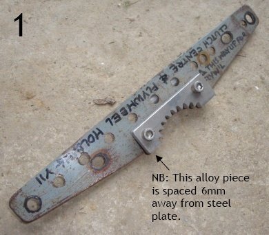

  7. I'm told you can align clutch plate by LOOSELY assembling clutch on the motor, attaching gearbox (requires a bit of jiggling to get input hub into splines in plate) then removing gearbox & tightening down clutch fully. I didn't have any luck with this method so made this, which worked fine. As I recall, I measured across gearbox bellhousing face to make tool, then attached it to motor across crankcase bellhousing face & used an old clutch hub to centre plate in clutch.

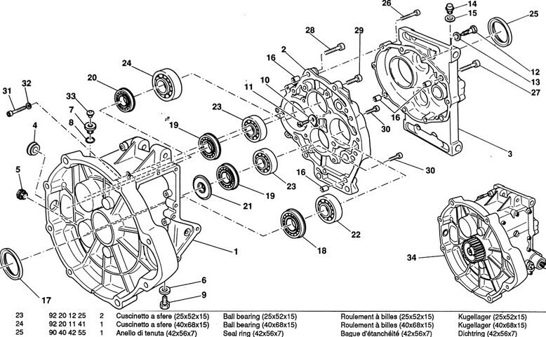

  8. It's the rear bearing on the upper lay shaft. #23 in this drawing. Part# 92 20 12 25 (ball bearing 25x52x15)

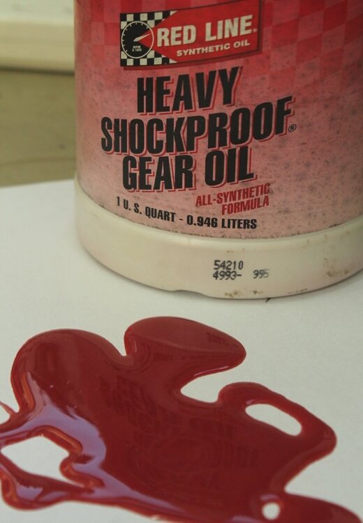

  9. Emulsified? Can't remember exactly what it looks like when fresh. this from a vintage 12 years old bottle...
  10. The failed bearing appears to be the rear bearing on the upper lay/secondary shaft. Here's 2 more:
